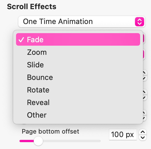

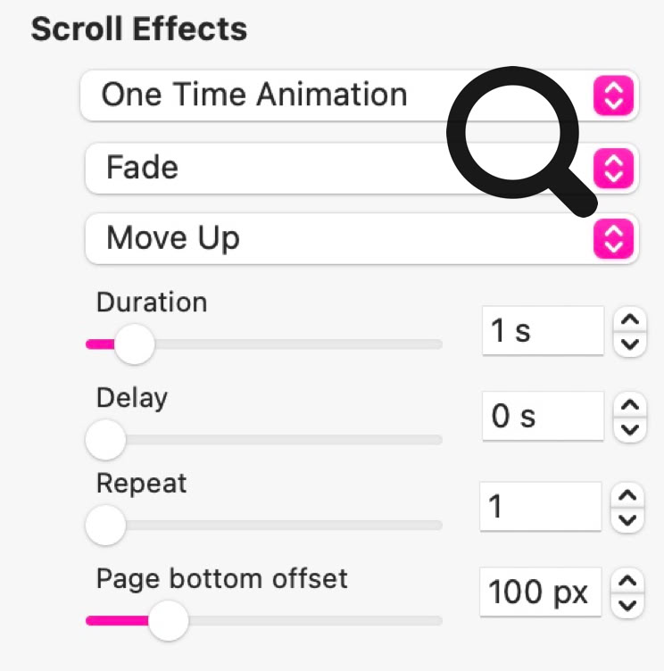

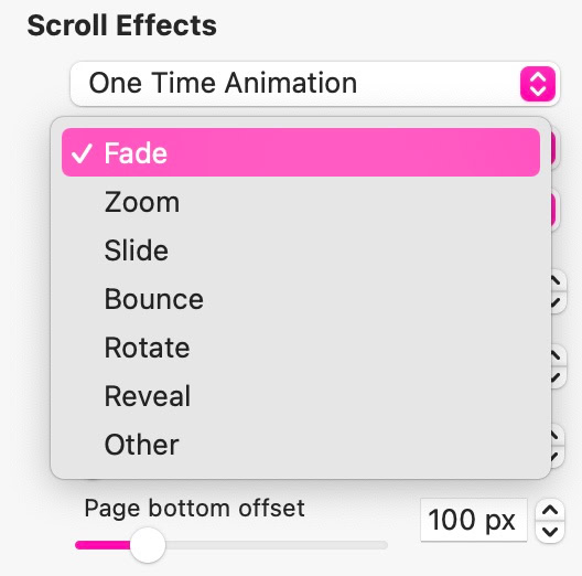

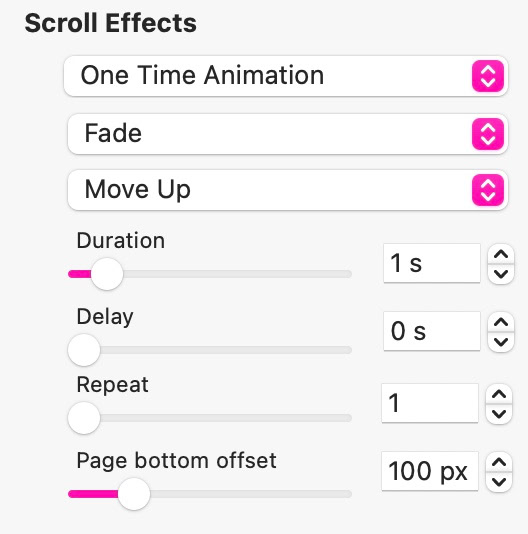

All animations are applied through the style panel on the right of the screen under the section named ‘Scroll Effects’. There you will see the option to apply one-time animations. Selecting that option will present you with a number of effects that can be applied. Just select an effect of your choice to apply it to your selected element on the canvas. If you select the ‘Other’ option, a secondary list of animations will appear, extending your choices even further.
When you select an animation, a number of other options present themselves, allowing you to choose different types of
movements for your animation, the duration of the animation, a delay time before the animation starts, and a number of repeats before the animation stops. One final option allows you to set the distance from the bottom of the browser viewport that the element must reach before the animation starts. Clearly, if you don’t set an offset, the whole animation may start and end before anyone actually sees it on the page.

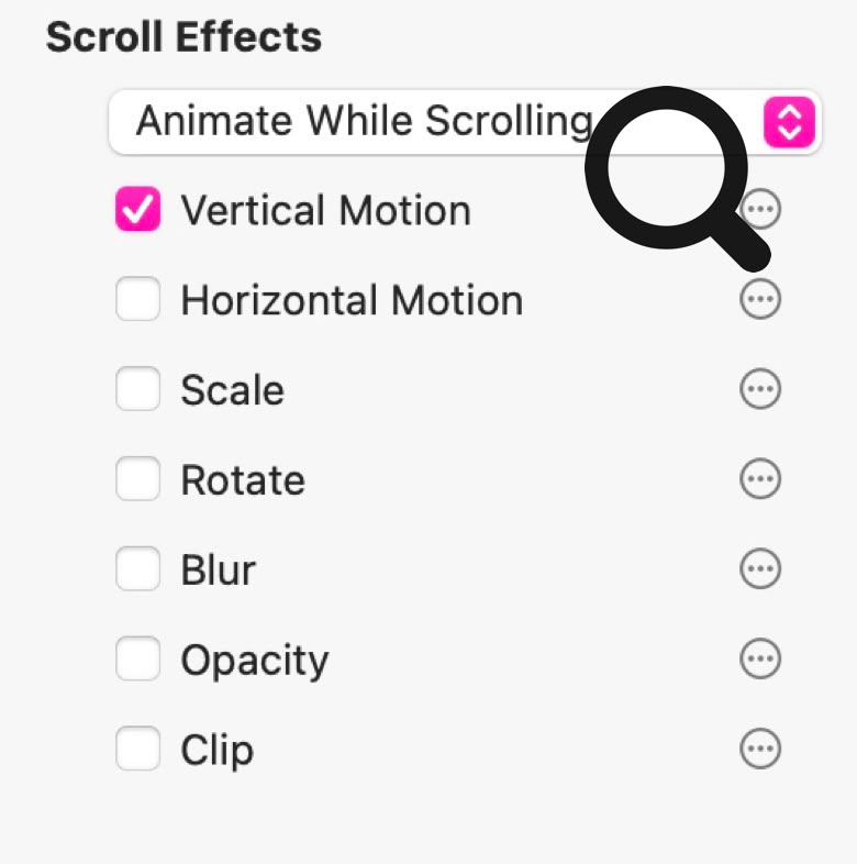

Scroll animations are applied by selecting the ‘Animate while scrolling’ option in the ‘Scroll Effects’ section of the style panel. There you will find all the basic scrolling effects that can be applied to elements on your canvas. Just select an effect and then adjust the settings to achieve the effect you want to create.
You adjust the settings by clicking on the settings icon on the right of the effect name. It looks like this:

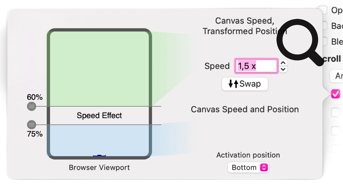

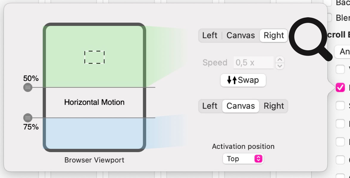

Sitely makes it very easy to set up this ‘Action Window’ through a simple graphical settings interface. When you click on an effect’s settings icon, you will see a popup where the settings are made. On the left side of the popup is a graphical representation of a device screen. Within that screen are two markers. You can slide these markers up or down to create your ‘Action Window’. In this example, the markers have been set to 60% (top) and 75% (bottom). The white
space in-between is our ‘Action Window’ where the effect takes place. This was the setting used for our sliding boxes example above.
Over on the right of the popup are effect-specific settings. Again, in this example of a vertical motion animation, we’ve set a speed of 1.5 times the speed of the scroll and we’ve told the animation to start when the bottom of the animated element is inside the ‘Action Window’. The end result? When the bottom of the element crosses the 75% marker, the element will begin its vertical movement upwards until it reaches the 60% marker. At that point, it stops moving. This assumes that the starting point of the element’s journey is the position it was placed on the canvas. But, what if we wanted it to start its movement sooner and end its movement at its canvas position? To do this we would click on the ‘Swap’ button to reverse the effect. Essentially, the element will start below its current position on the canvas and move upwards into its canvas position. The point at which the element starts its journey is determined by the bottom zone marker.
Settings Variations

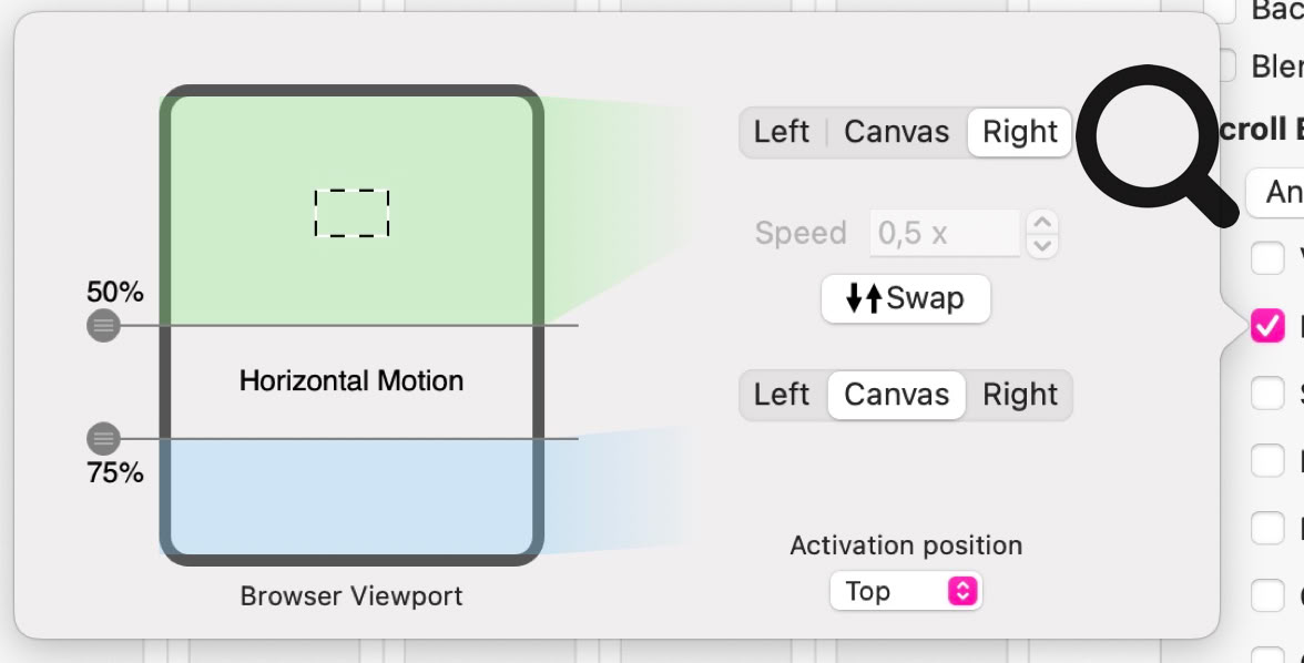

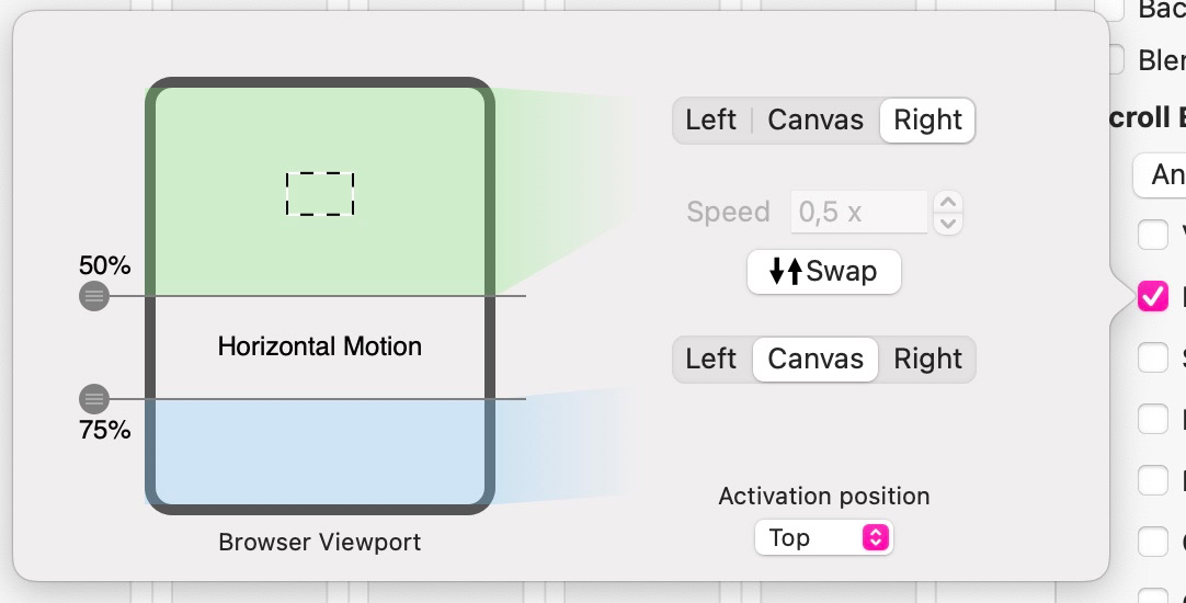

Each animation effect will have slightly different settings, but they all follow the same general principles. Set an ‘Action Window’ and then apply settings to achieve the desired effect. For example, with horizontal animations, you can set the direction of movement. In this example, we set an element to move from its canvas position towards the right of the screen. The bottom row of direction buttons tells the animation the starting position of the element, while the top direction buttons show the direction of movement.
The thing to note about horizontal animation is that the route of travel is unlimited, essentially, the element will move right off the screen edge during the time it takes to scroll through the ‘Action Window’. So, the bigger the ‘Action Window’, the longer it will take for the animation to complete. If you wanted to restrict the horizontal motion so that the element doesn’t fly completely off the screen, you can set both sets of direction buttons to ‘Canvas’. This will allow you to set a scroll speed, which basically restricts the movement. This results in the animation starting when the element enters the ‘Action Window’ and will stop when it exits the window. If the scroll speed is set low enough (typically below 1x), the animation will stop before it has time to fly off the edge of the screen. Here is an example of that effect. It uses a very small ‘Action Window’ and a low speed. If the window size was increased, the element would continue moving towards the right of the screen edge until the page scroll reaches the top of the ‘Action Window’
