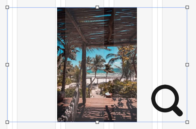

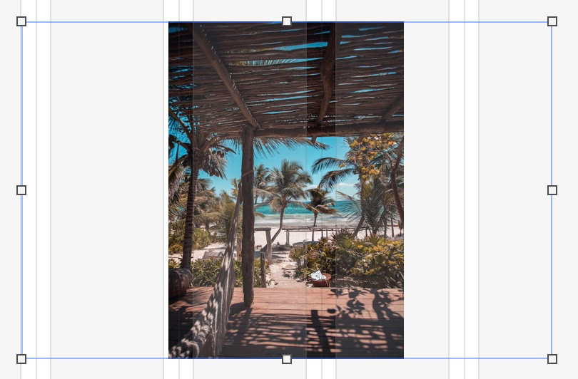

The image will, in most cases, be placed at its original dimensions and aspect ratio. To adjust the size of the image while retaining its proportions, hold down the shift key while dragging a corner handle. You can also change the image dimensions by dragging any of the resize handles without holding the shift key. This action will increase the size of the image box while keeping the image within the boundary of the box. You can use ‘Fit’ in the cropping controls to show the whole image within the box.

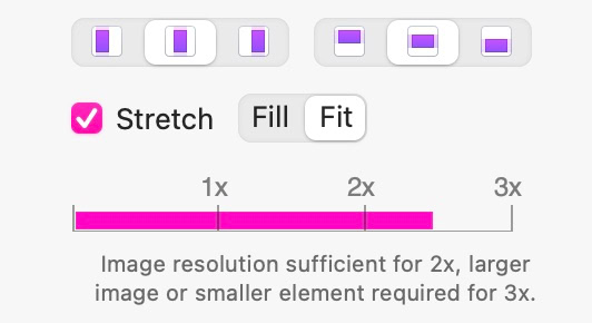

Fit mode keeps the complete portrait photo inside a wide image element, leaving space on both sides.

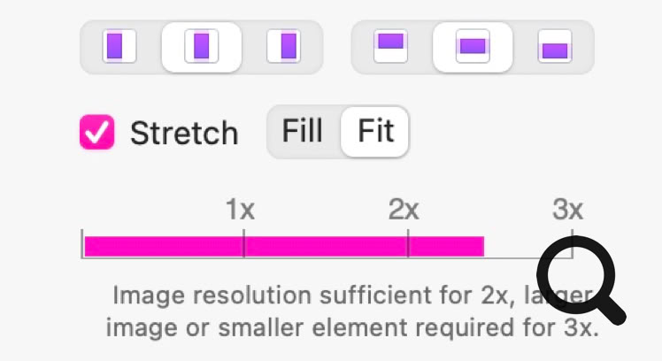

Image resolution meter indicating sufficient resolution for 2x, with a larger source needed for 3x.
In the above example, the ‘Fit’ option has been selected in the cropping controls. In most cases, any image of less than 2x (twice the displayed pixel dimensions) should be avoided if you want to maintain a high quality look to your website. The other sizing option is ‘Fill’. Selecting this option will enlarge the image proportionately until it fills the box completely.
Fill mode crops the portrait beach photo to cover a wide image element.
‍The fill option will effectively crop the image, in this example, the top and bottom of the image is cropped. By default, the cropped image will be centered within the image box. However, you can change the focus of the image with the alignment buttons in the cropping controls. There you can choose to have the top, middle or bottom of your image display in the box. If this were a landscape image placed in a portrait box, you could set the image box to display the left, center or right of the image.
Image positioning palette with Fit, Fill, alignment, flip and crop controls.

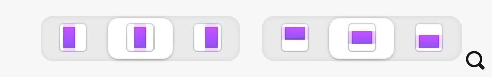

Drag the image to change its position within the frame, and use the corner handles or the zoom slider to adjust how much of the image is visible. For a standard image element, the two handle options let you choose whether you’re adjusting the image within its frame, or the frame around the image. This makes it easy to bring the subject into view without having to prepare a separate cropped image in another application.
Image crop controls with Fit, Fill, alignment, mirroring, rotation, image and frame handles, and zoom.
The ‘Fit’ and ‘Fill’ buttons provide a quick starting point. ‘Fit’ shows the whole image within the frame, while ‘Fill’ covers the frame completely, cropping any part that extends beyond it. The alignment buttons let you position the image to the left, center or right, and at the top, middle or bottom. You can also mirror the image horizontally or vertically, or rotate it 90 degrees counterclockwise with each click of the rotate button.

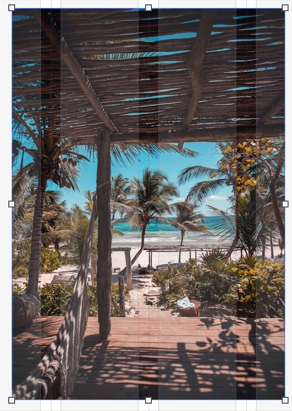

Palm trees and a beach seen through a shaded wooden pergola.

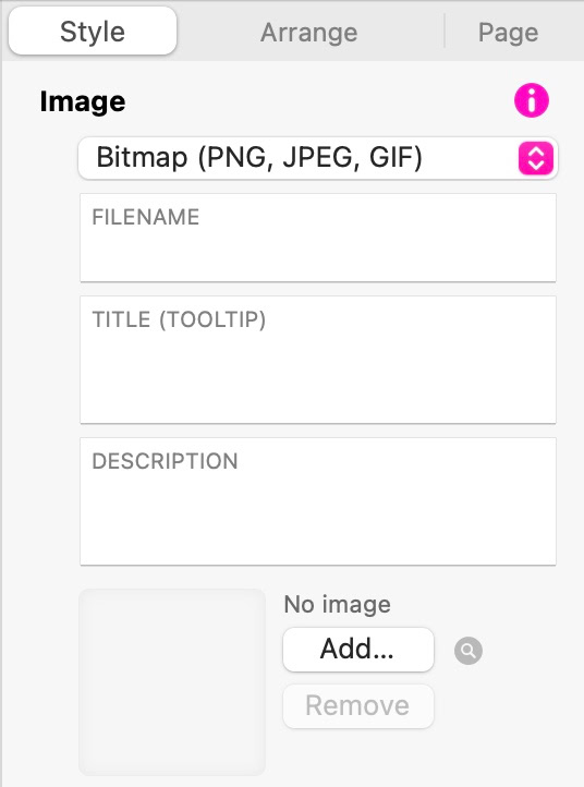

Adding Images with the Image element

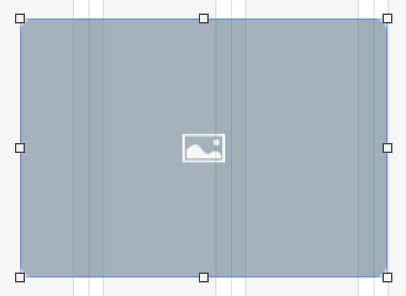

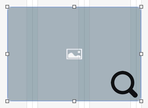

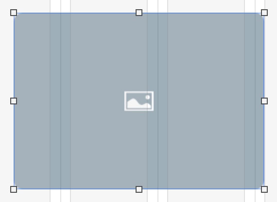

The image element is a great tool when first setting out your web page design. It effectively places an image placeholder on the canvas which you can later populate with an image of your choice. When first placed on the canvas, it looks like this.

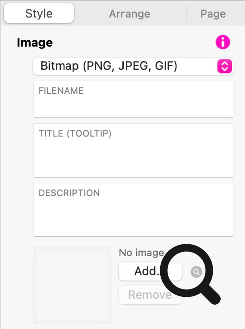

An empty image placeholder selected on the canvas.
When you’re ready to add images, just select the placeholder, and add your image from the style panel.
Bitmap Image inspector with empty filename, tooltip and description fields and an Add button.

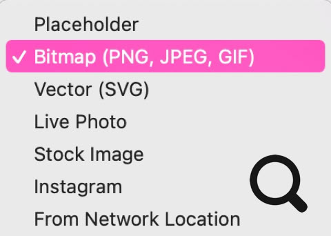

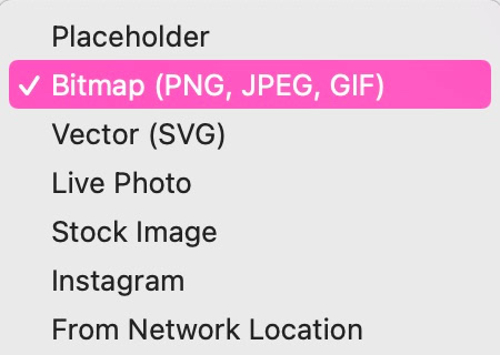

‍Clicking the ‘Add…’ button will allow you to browse for an image on your computer. You also have other image sources to choose from. Clicking on the ‘Bitmap (PNG, JPEG, GIF)’ selector will reveal the available sources.
Image source menu with bitmap, SVG, Live Photo, stock, Instagram and network options.

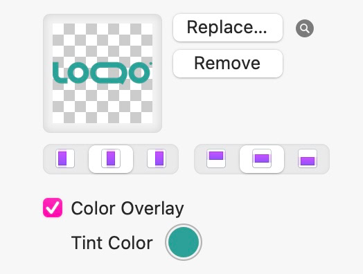

Vector (SVG)

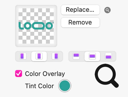

These are typically pure graphic elements such as Logos, Icons or illustrations. These are created in vector graphic applications and usually have a very small file size. They are good in web design work because they can be scaled to any size while retaining their sharpness. They also have the advantage that they can be recolored right within Sitely using the color overlay option in the style panel. Here is an example of an SVG Logo in both its basic monochrome form and as it will look with a color overlay applied.
Original dark vector logo before a color overlay is applied.
The same vector logo recolored teal using Color Overlay.
SVG image settings with Color Overlay enabled and a red tint selected.
‍Some SVG’s will already be created with several colors. They can be used as they are and will retain all the advantages of the SVG format. However, using the color overlay option will remove the multi-color feature of the SVG. Here’s an example:

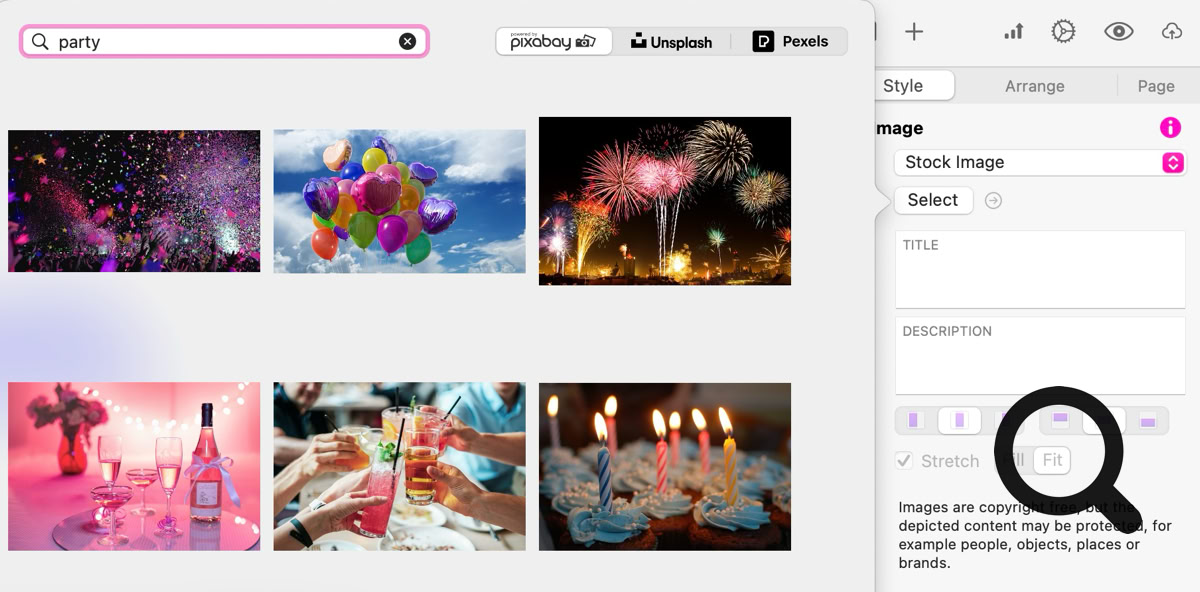

Stock Image

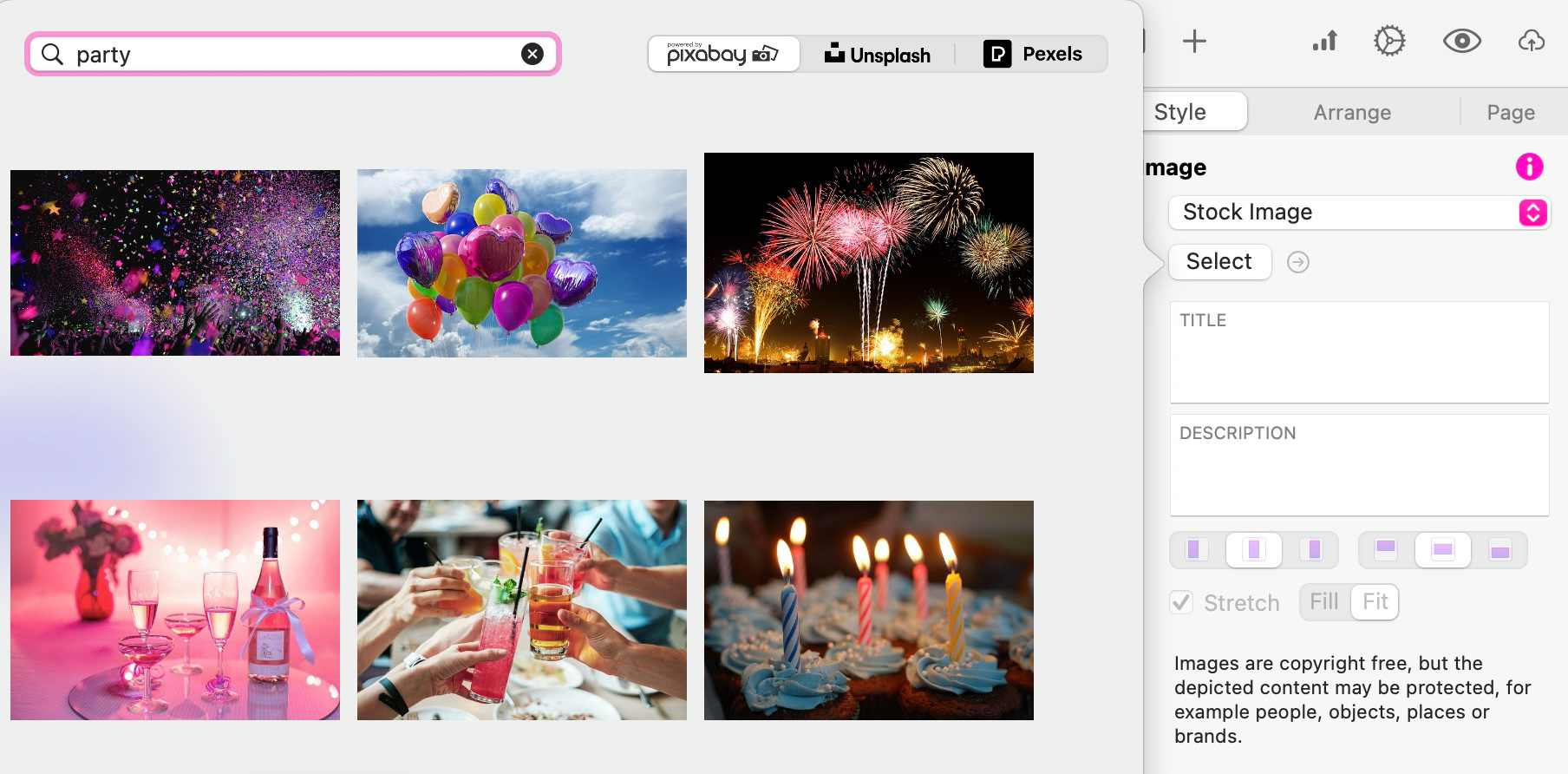

This option gives you quick access to three of the most popular stock image libraries on the Internet, Pixabay, Unsplash and Pexels. Just hit the ‘Select’ button, choose your platform, and start your search for the perfect image.
Stock image search results for party, with Pixabay, Unsplash and Pexels sources.
Important Note: Although stock images from these platforms will generally be available for use under very liberal licensing terms at no cost, access to the libraries through the Sitely interface does not imply that the images may be used without restriction in every situation, particularly images that may contain faces of real people or trademarks. You are advised to check the specific license terms of any image you use on the website of the relevant platform.

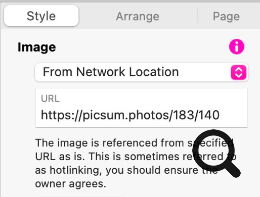

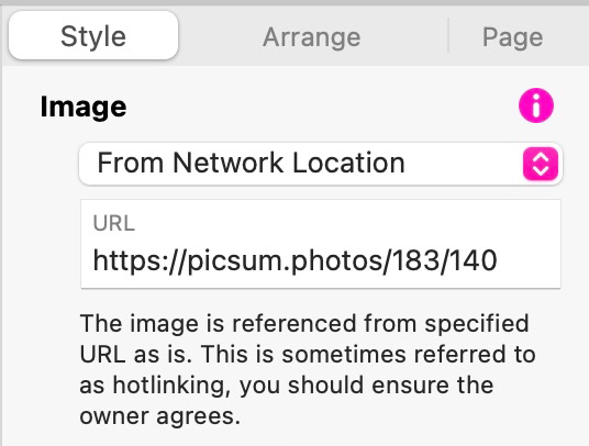

From Network Location
This option allows you to add images hosted on a remote server by entering the image URL in the style panel. This is often referred to as ‘Hot-linking’ and should only be used if you are the owner of the site you’re linking to, or you have permission from the site owner.
From Network Location image settings with a URL and Load sample button.

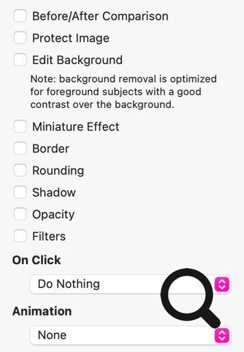

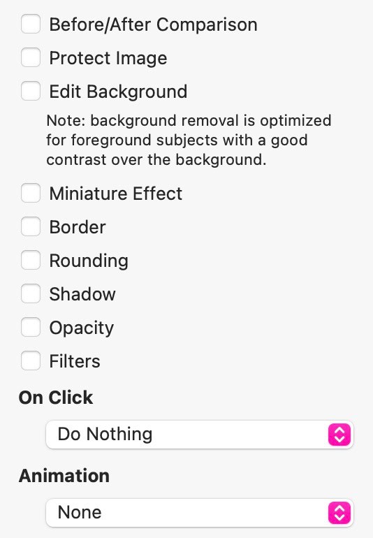

Styling Options
These are all listed in the styles panel, as shown here. Checking the styling checkboxes will reveal additional settings for each option. Additionally, you will be able to attach any of Sitely’s on-click actions to your images, as well as scroll or one-time animation effects.
Image styling options including background editing, reflection, border, shadow, filters and animation.

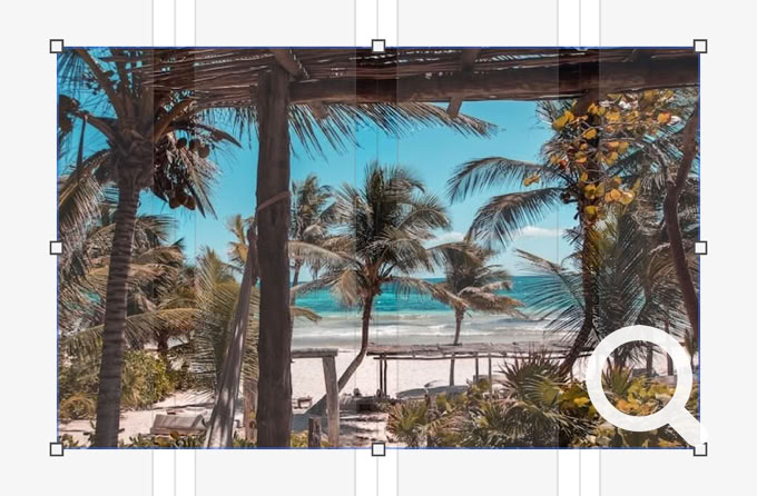

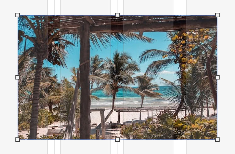

Zoom icons and lightboxes
To let visitors enlarge an image, choose Zoom Image in Lightbox as its On Click action. Enable its Zoom Icon to make that action visible. Choose a built-in icon or custom artwork, then set its size and position; you can also position the icon on the canvas. Position is measured within the image, while the icon size is in pixels. Enable a tint when the selected artwork supports it.

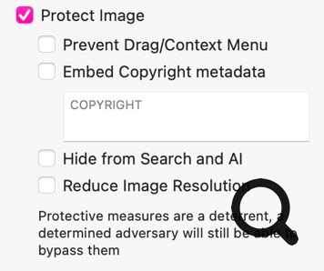

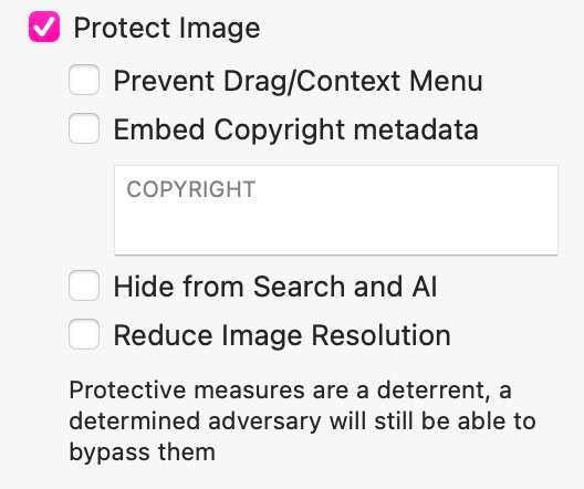

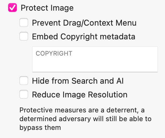

Protect Image
How you feel about protecting images is a personal matter. Inevitably putting something on the web makes it public, and might invite someone to steal it. While someone who’s determined to steal your content is always going to find a way, there are a few things that can be done to mitigate, while still showcasing your work. Protect Image is offered for bitmap and stock images and hidden while Before/After is on. Reduce Image Resolution is unavailable for GIFs.
At the simplest level you can prevent the image from being dragged from the page, or saved after a right click. For many of our customers this has historically been a “good enough” solution that they were seeking.
Embedding copyright information in the image, which will be taken from the original image if available, is often also a good solution. So for example photographers will find it from the camera or from their processing software such as Lightroom.
Both these techniques are not going to help with slightly more sophisticated users, who will view the page source, or crawlers that download images on behalf of AI systems or image search services. So for those we developed a novel “Hide from Search and AI” option, that is not impossible to work around, but needs a focused adversary who is technically knowledgeable and wants your image specifically.
Ultimately if you recognize that the image will just be grabbed by whoever wants it, but still need to show it, you can opt to reduce the image resolution, so that whoever manages to grab it never has the best image quality.

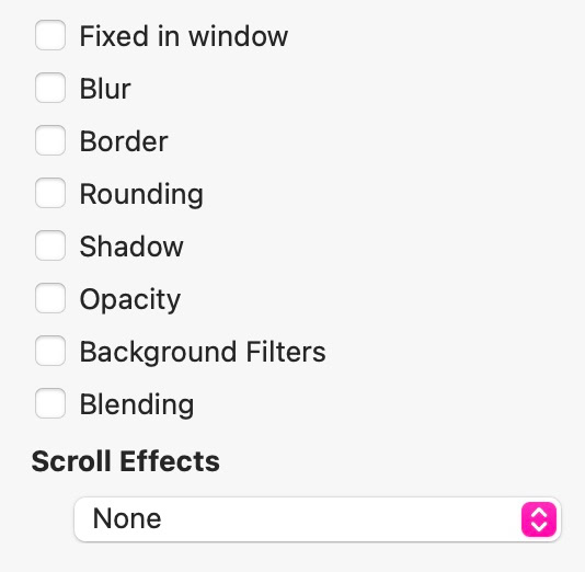

Other Image Placement Options
Images can be applied to other elements of your Sitely page. For example, you can fill a standard box with an image. While this may seem identical to adding an image box to the page, this option gives you a different set of features compared to a standard image element. The first thing you will notice are some additional styling options in the style panel.
Fixed in Window
This option sends your image behind your web page, leaving the original box as a sort of window through which you can see the image behind. The image itself will remain fixed, while the box will roll over it as the page scrolls, revealing different parts of the image.

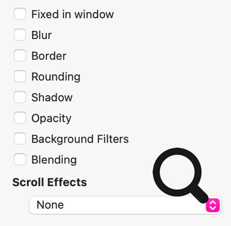

Image placement and appearance settings including Fixed In Window, blur, blending and background filters.
Blur
Here you can add blur to your image, which is a simple way to create a colorful background for something like a site header. Here is an example of a blurred image overlaid with a text box.

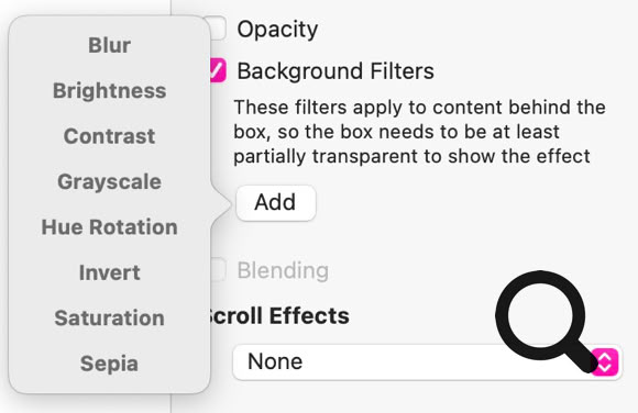

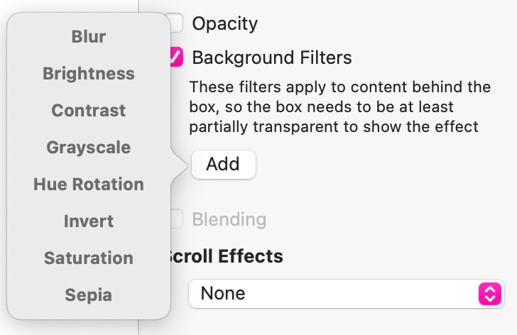

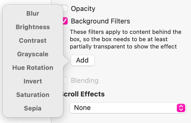

Background Filters
These options allow you to create some interesting effects, particularly for images that you may be applying scroll effects to. These filters do not change the image as such, but instead change the background behind the image. This means that the image must be partially transparent, or contain a transparent area (as in a PNG image) for the effects to be seen. To see how this works, a Blur filter has been applied to the ‘Eye’ Image on the right. As this page scrolls, the image will move up the page and start overlapping the content above it. When it overlaps, the content behind the image will blur. There are a number of effects for you to experiment with, so try them all to get a feel of how each works.
Blending
This is something for those with a little knowledge of blending effects. These are often used in graphic arts to create some interesting effects. For blending to work, there must be at least two elements, one placed above the other. The blending effect is then applied to the top most element. The option chosen will blend the two elements to create an effect. In this example, a red box has been blended with an image using the ‘color burn’ blend effect.
Text over a Blurred Image
Background Filters enabled, with a menu of blur, brightness, contrast and color effects.

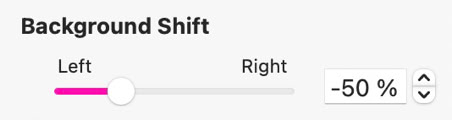

In this example, two wide boxes have been added to the page, each with a background shift applied. The same background image was applied to both boxes and the ‘Fixed in Window’ option selected.
The background shift option obscures a portion of the background image, allowing other content to be added into the obscured portion of the page. This option is available on any full width box added to the page. The option looks like this.
Background Shift control set to −50%, toward the left.

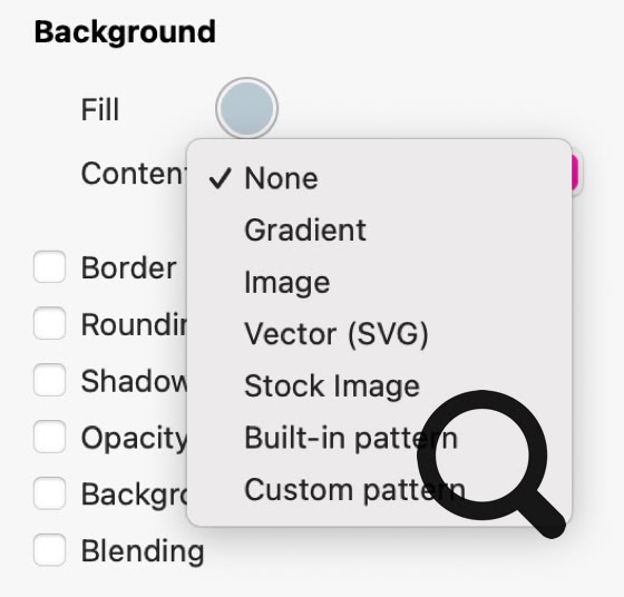

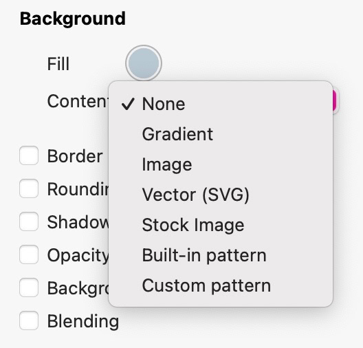

Layout Block Backgrounds

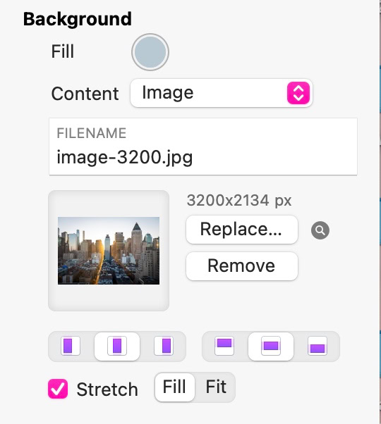

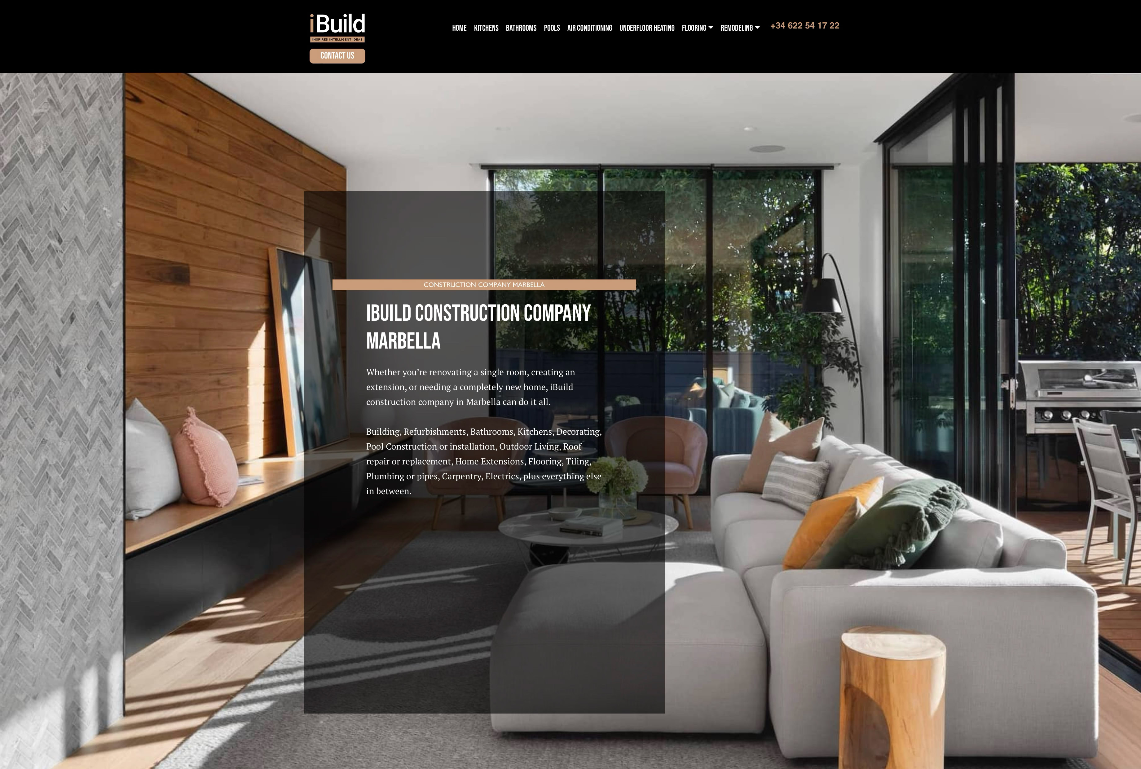

Wide boxes and layout blocks, including image/video grids, and Layout Grids can also have images set as their backgrounds. These elements span the entire browser width and can create dramatic full-width page elements to your website. This feature is commonly used to make a website Hero section, such as in the illustration below.

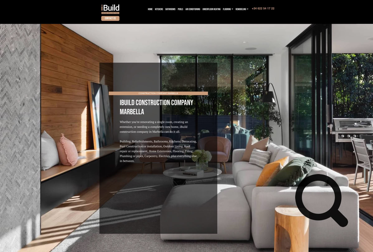

Website example with a translucent dark text panel over an interior photograph.

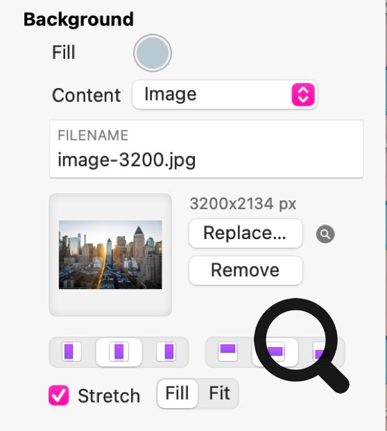

You add images to layout blocks and wide boxes in the background section of the style panel. You will be presented with the same choices as standard image boxes, plus a few additional fill options such as gradients and patterns.
Images used as backgrounds are particularly effective when used with the ‘Fixed in Window’ option, creating a parallax-type effect where the web page rolls over the image as it’s scrolled.
Box content menu with gradient, image, SVG, stock image and pattern options.

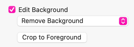

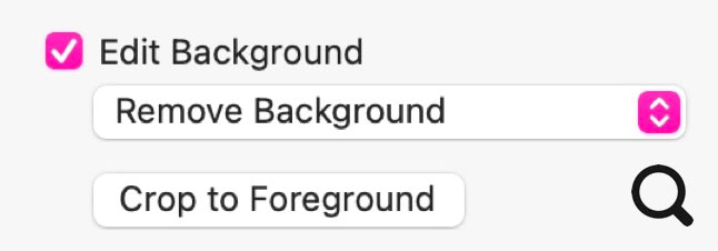

With the original image selected, check the edit background box in the style panel. Choose the option to remove background. The result will be a transparent image as can be seen here. You can also have Sitely automatically crop the image to the foreground.
The same portrait after removing the gray background.
Edit Background enabled with Remove Background selected and a Crop to Foreground button.
