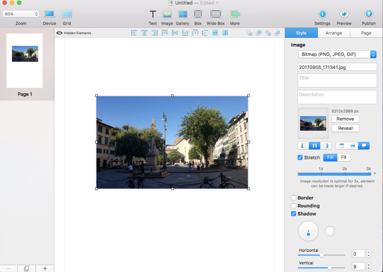

Add an image and set its crop so the part you want to mirror reaches the bottom edge. Duplicate the image.
Reflection tutorial: a landscape photo selected before duplication.

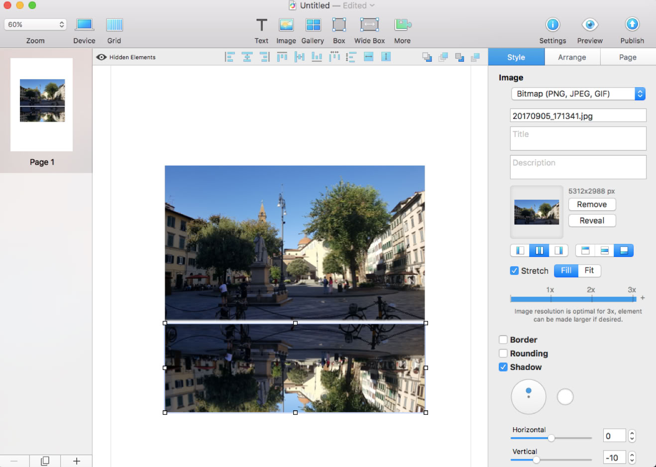

Flip the copy vertically and position it directly below the original. Make it shorter than the original image, and adjust its crop so the two edges line up. A small gap creates the appearance of a raised object.
Reflection tutorial: a vertically flipped copy positioned below the original photo.

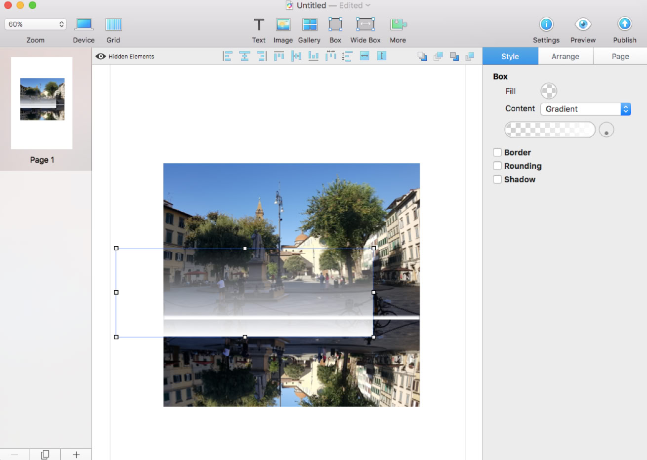

Add a box over the flipped image and give it a vertical gradient. Make the top stop transparent and the bottom stop match the page background so the mirror image fades away.
Reflection tutorial: a gradient box placed over the reflected photo.

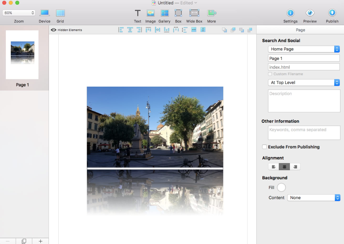

‍Align the box with the flipped image and check the join and fade in Preview. If the site has a dark theme, check that the gradient matches that background as well.
Completed reflection effect, fading the mirrored photo into the white page.
