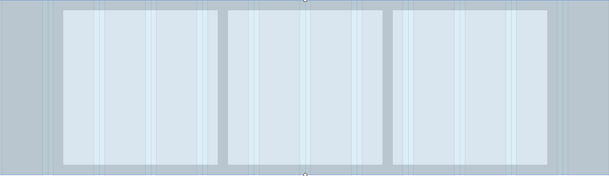

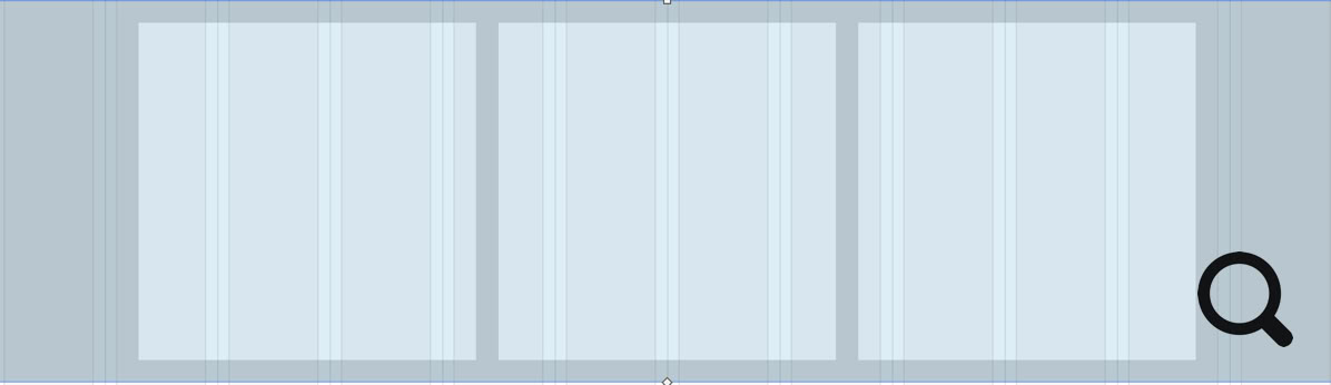

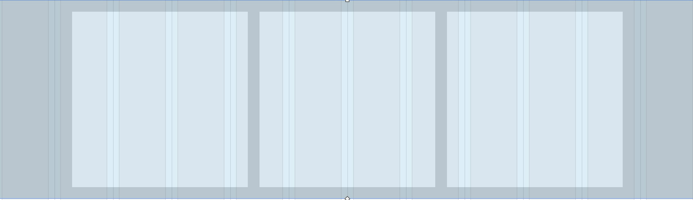

Insert a Layout Grid and select its outer frame to edit the whole grid. A new grid starts with three cells. The illustrations below show how cell size, spacing and spans build up the layout.
New Layout Grid with three equal cells in one row.

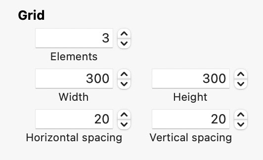

Set the base cell size and spacing

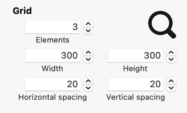

In the Style inspector, Elements sets the number of cells; Width and Height set the base cell dimensions. Horiz. Space and Vert. Space control the gaps. The available width, margins and alignment determine how many cells fit on a row. Add cells or change the dimensions, then check the resulting rows on the canvas.
Grid controls for cell count, base dimensions and horizontal and vertical spacing.

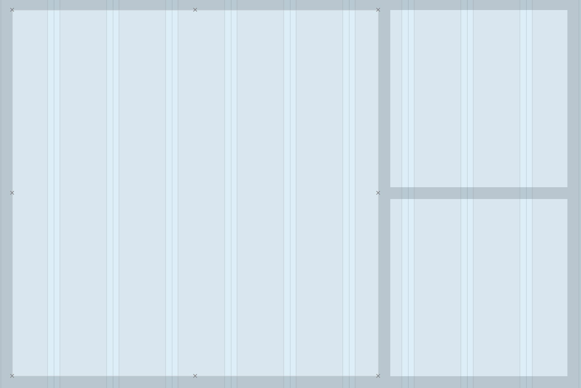

Make cells span rows and columns

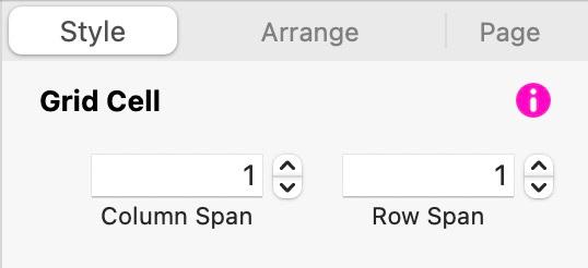

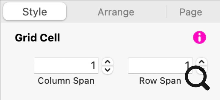

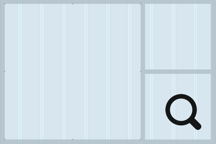

Select a cell and change Col. Span or Row Span in the Grid Cell section. A span is a number of base cells, including the spacing between them. The grid packs the remaining cells around the larger one.
Column Span and Row Span controls for the selected grid cell.
A first cell spanning two columns and two rows creates one large card beside smaller cards.
First grid cell spanning two columns and two rows beside smaller cells.

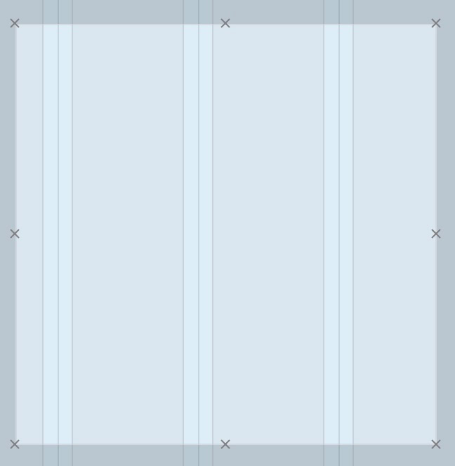

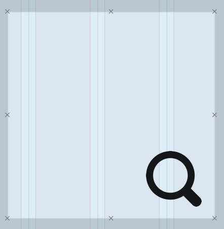

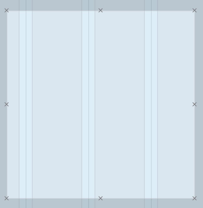

If Grid Cell is missing, select the cell itself rather than the grid’s outer frame or an element inside it. The selected cell has small × handles around its edges. Use Layers to reach it when its contents cover the cell.
Selected grid cell marked by small cross-shaped handles.

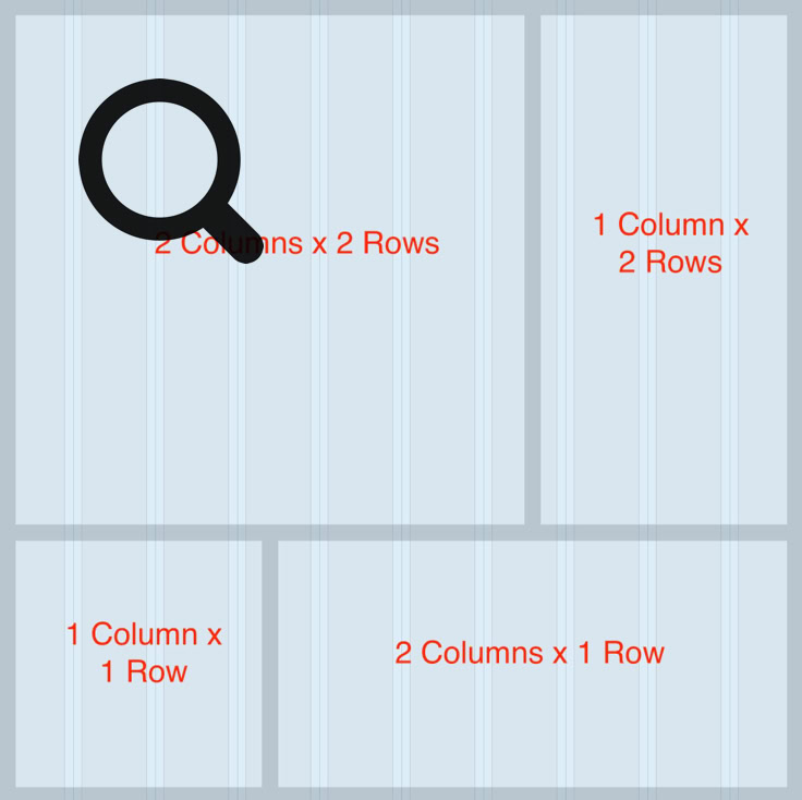

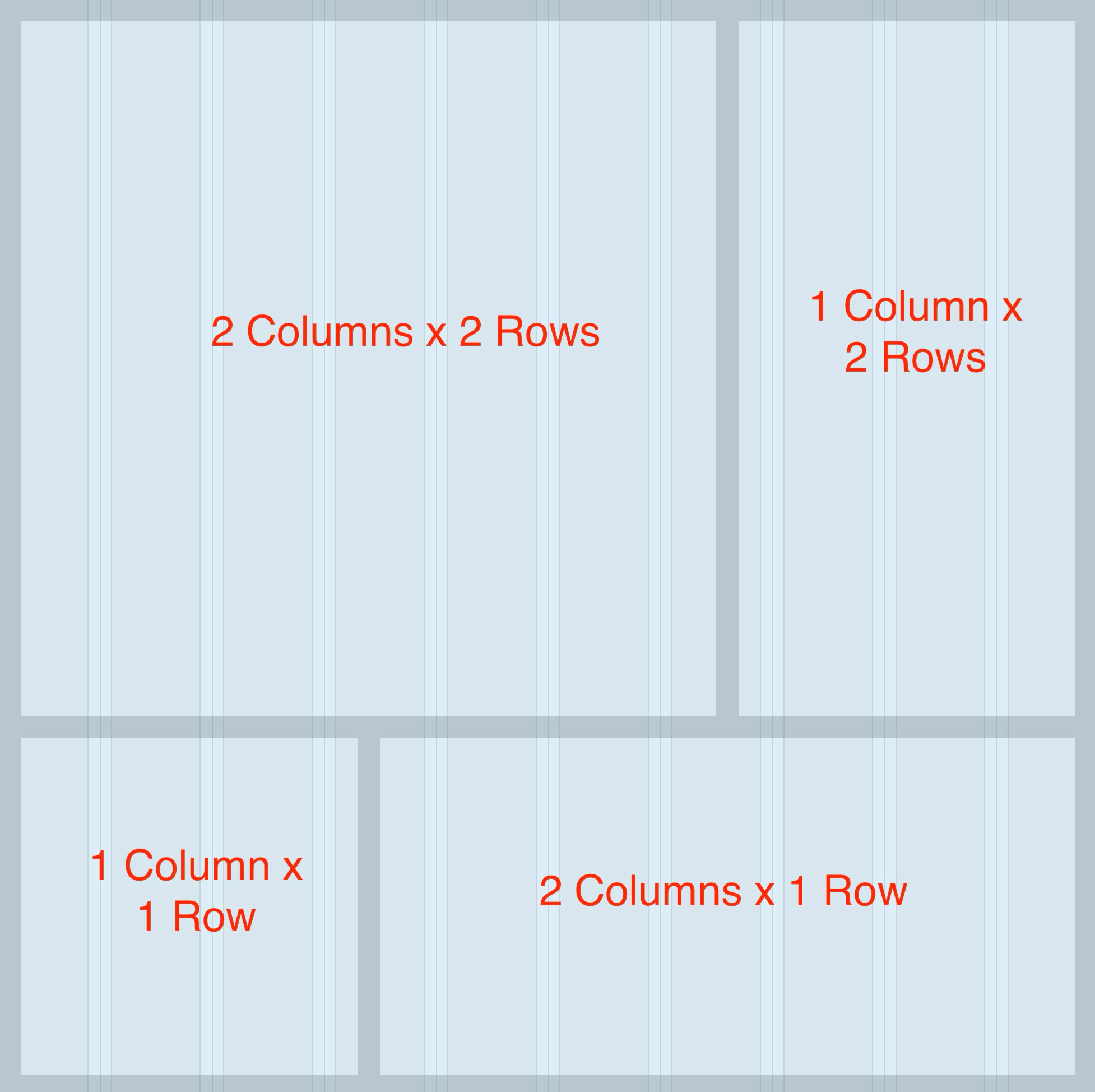

Work through the cells and adjust their spans until the composition has the intended hierarchy. The labels in this example show the column and row spans of each cell.
Mixed cell sizes labeled with their column and row spans.

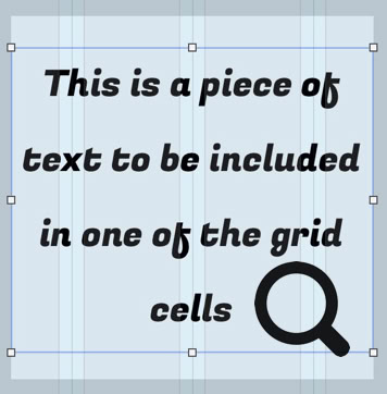

Place content inside a cell

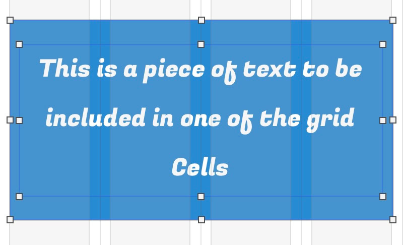

Create and style an element, then drag it over a cell. Release it when the cell highlights as a drop target. A cell can contain several elements, such as an image, a heading and a button. Group a related composition first when you want to move it into the cell together.
Style the grid background separately from its cells. Fill, borders and rounding can define a card’s surface without adding a background box to every cell.
Text being dragged over a highlighted grid cell.

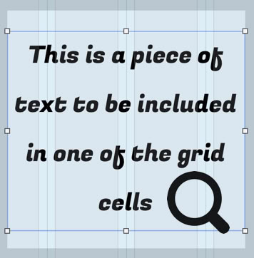

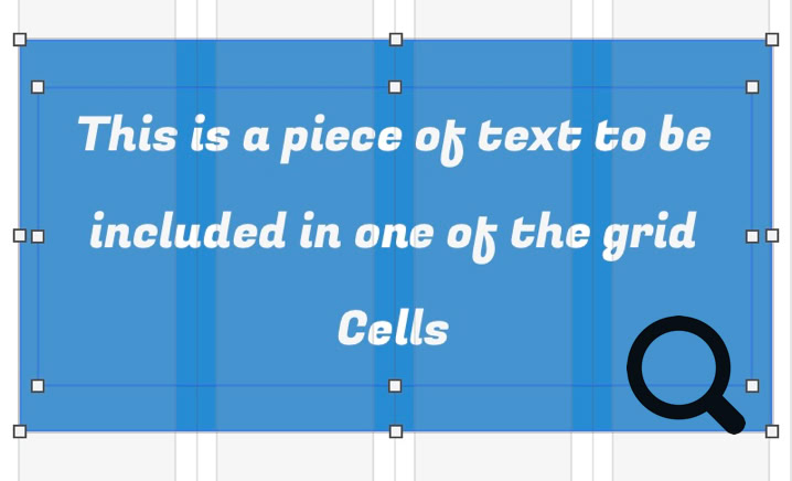

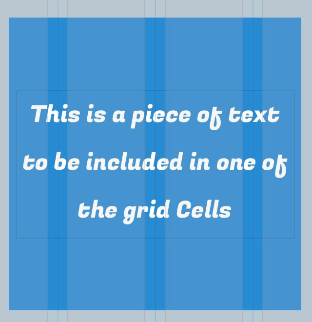

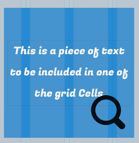

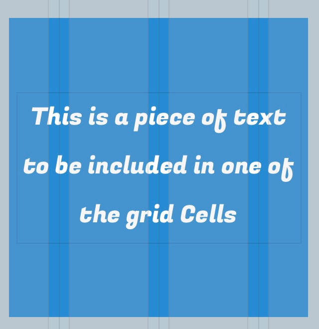

Select a contained element to resize it or adjust its text. Mask Contained Elements controls whether material outside the cell is clipped. A larger element is not automatically reduced to fit: check its framing and keep headings, buttons and focus indicators inside the visible area.

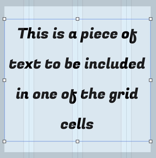

Text and a blue background box grouped before insertion into a cell.
The same grouped text and background placed inside a grid cell.
The background box and the text remain separate editable elements inside the cell.

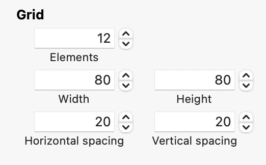

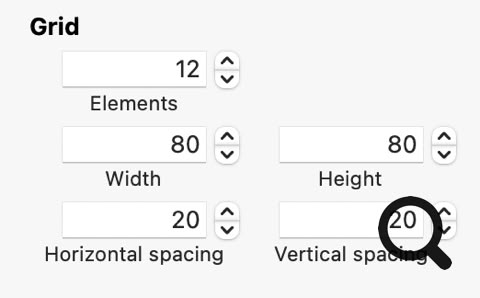

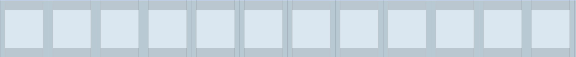

Start with a small base cell and create the larger cards with spans. A twelve-column structure gives you many combinations: for example, three columns for a narrow card and six for a wide card. Choose base dimensions and gaps that fit the page width, rather than stretching the contents to fill an arbitrary grid.
You can align the element with the canvas column guides, but the two grids have independent settings. The following example uses a 12-column foundation; your design can use a different number.

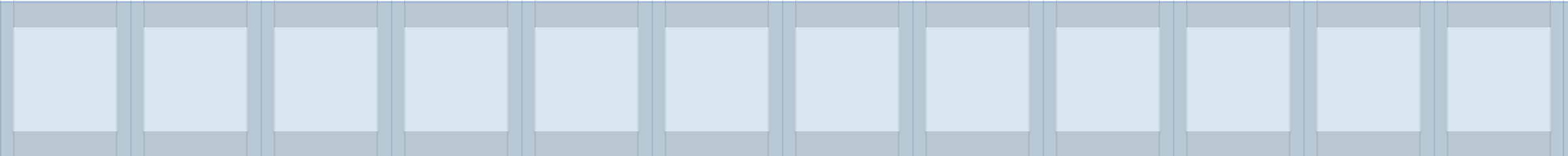

Layout Grid settings for a twelve-column foundation.

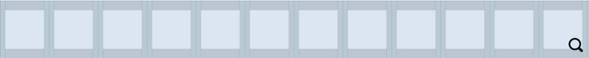

Small base cells form a framework for larger column and row spans.
Twelve small base cells forming a single grid row.
